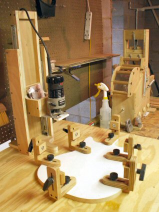

i've got the 'guitar jigs' router jig and it's got a flush trimming guide which works fast and great. the problem is that i'm currently working on wenge back and sides and feel certain that pieces might go flying if i ask the router to take off excess back that is not glued onto the rims/kerfing.

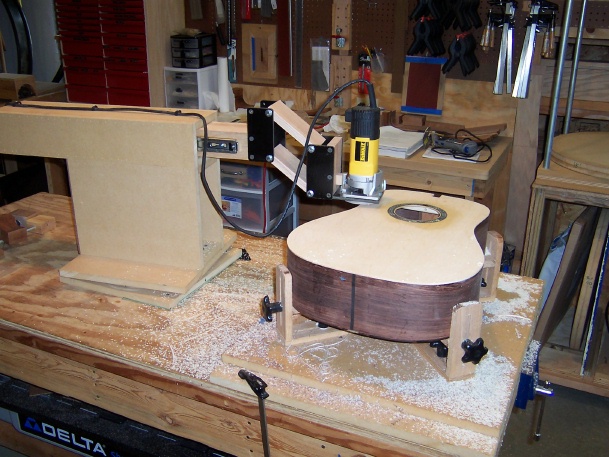

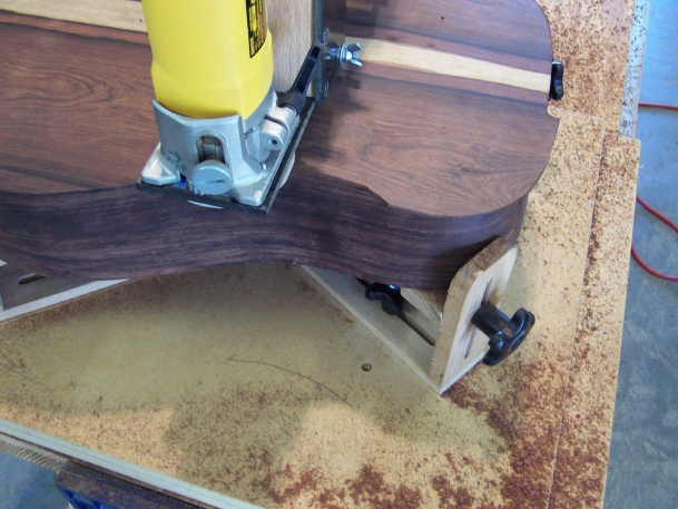

I just did the trimming last week on my Celtic build. Here is a photo doing the climb cuts. Notice an arrow drawn on the guitar holding jig that reminds me where to stop and start the cuts.   In the 2nd photo, I've just finished trimming the top and you can see the Williams jig. I use a spiral downcut bit.

How does this jig follow a sloping back and provide a perpendicular cut? Does it pivot about the horizontal axis?
